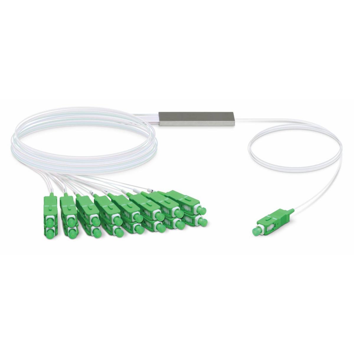

The UFiber splitter carries data from a UFiber OLT’s long-haul cable and shares it with multiple UFiber ONUs. Available with 4, 8, 16, or 32 outputs. PLC Splitters UF-SPLITTER-4 UF-SPLITTER-8 UF-SPLITTER-16 UF-SPLITTER-32 Input (1) SC/APC (1) SC/APC (1) SC/APC (1) SC/APC Outputs (4) SC/APC (8) SC/APC (16) SC/APC (32) SC/APC Insertion Loss with Connectors 7.4 dB 10.5 dB 13.7 dB 17.0 dB Uniformity Loss 0.6 dB 0.8 dB 1.2 dB 1.5 dB Polarization Dependent Loss 0.3 dB 0.3 dB 0.3 dB 0.3 dB Wavelength Bandwidth 1260-1650 nm 1260-1650 nm 1260-1650 nm 1260-1650 nm Return Loss (All Ports) 50 dB 50 dB 50 dB 50 dB Directivity 55 dB 55 dB 55 dB 55 dB Fiber Type G657A1 G657A1 G657A1 G657A1 Operating Temperature -40 to 85° C (-40 to 185° F) -40 to 85° C (-40 to 185° F) -40 to 85° C (-40 to 185° F) -40 to 85° C (-40 to 185° F) Total Length 4.06m (13.32') 4.06 m (13.32') 4.06 m (13.32') 4.08 m (13.39') Weight 58 g (2.0 oz) 62 g (2.2 oz) 110 g (3.9 oz) 160 g (5.6 oz)
