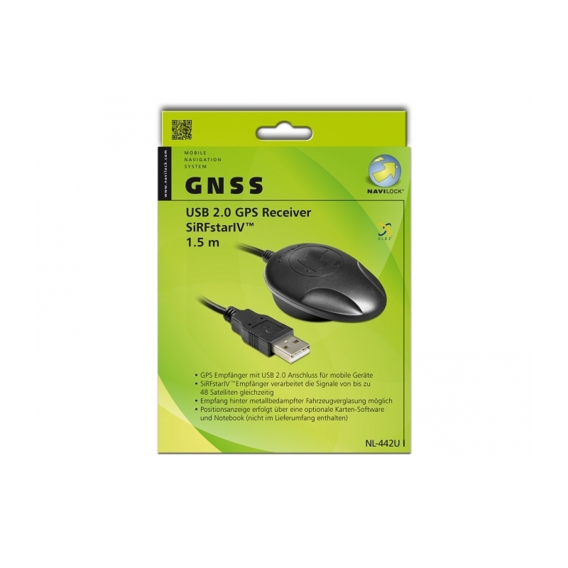

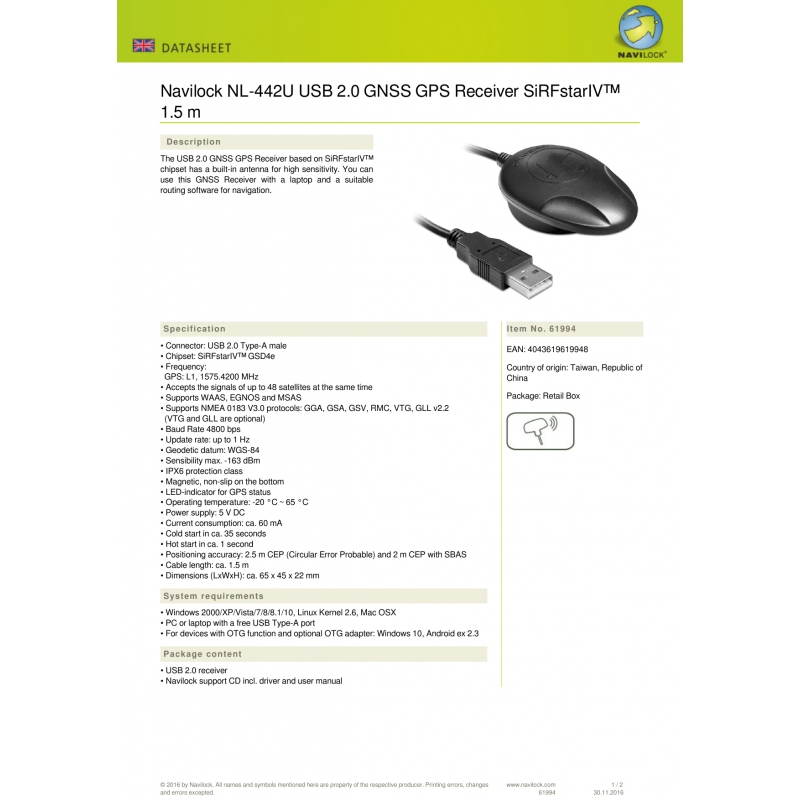

Description The USB 2.0 GPS Receiver based on SiRFstarIV™ chipset has a built-in antenna for high sensitivity. You can use this GPS Receiver with a notebook and a suitable routing software for navigation. Specification • SiRFstarIV™ GSD4e chipset • Frequency: L1, 1575.42 MHz, C/A Code: 1.023 MHz • Accepts the signals of up to 48 satellites at the same time • Supports WAAS, EGNOS and MSAS • Supports NMEA 0183 V3.0 protocols: GGA, GSA, GSV, RMC,   VTG, GLL v2.2 (VTG and GLL are optional) • USB specification 2.0 • 4800 baud rate • Update rate: 1 Hz • Datum: WGS-84 • Sensibility max. –163 dBm • IPX6 protection class  • Magnatic, non-slip on the bottom • LED-indicator for GPS-status • Operating temperature: -20 °C to +65 °C • Cold start in about 35 sec. • Hot start in about 1 sec. • Positioning accuracy: < 2.5 m 2D RMS SBAS Enable • Dimension (LxWxH): 65 mm x 45 mm x 22 mm System requirements • Windows 2000/XP/Vista/7/8/8.1/10,   Linux ab Kernel 2.6,   Mac OS 10.6.x, 10.7.x • PC or Notebook with a free USB port Package content • USB 2.0 Receiver • Driver CD • User manual on CD ROM Package • Retail Box
